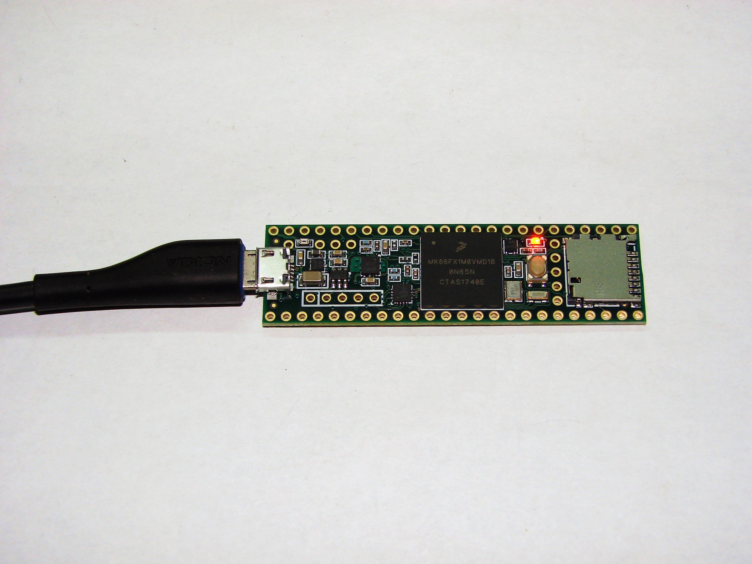

Teensy v3.6 ... Blink :pleasantry
// Pin 11 has the LED on Teensy 2.0
// Pin 6  has the LED on Teensy++ 2.0
// Pin 13 has the LED on Teensy 3.0
// Pin 13 has the LED on Teensy 3.6
int led = 13;
// the setup routine runs once when you press reset:
  pinMode(13, OUTPUT);
  digitalWrite(led, HIGH);   // turn the LED on (HIGH is the voltage level)
  delay(1000);               // wait for a second
  digitalWrite(led, LOW);    // turn the LED off by making the voltage LOW
teensy_v3.6_wsg.jpg [ 1.47 MiB | Прегледано 12283 пъти ]
Teensy v3.6, 32 bit, 180 MHz, ARM Cortex-M4 processor, 3.3V

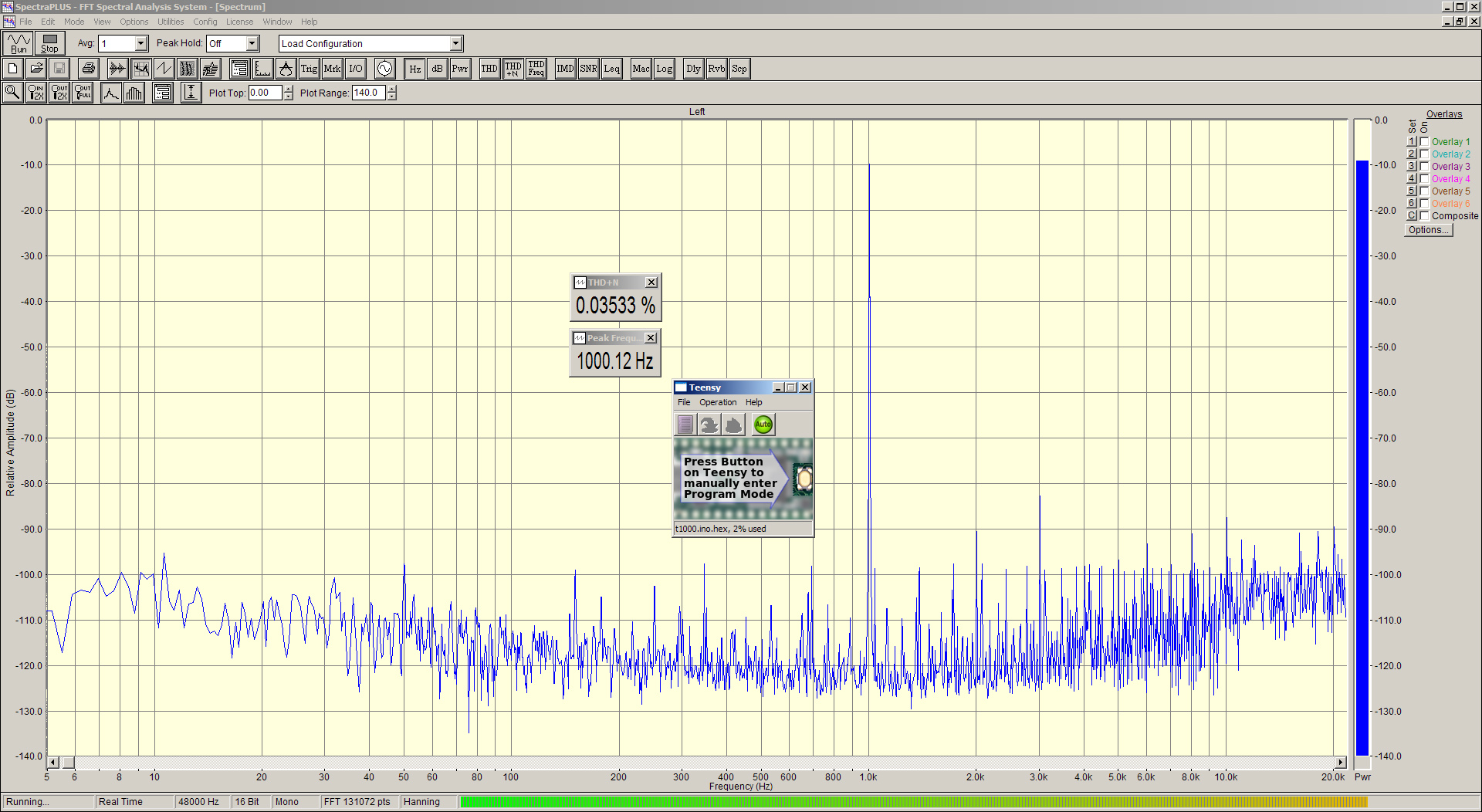

МнениеПубликувано на: 02 Май 2019, 02:50
1 kHz с вътрешния си 12 битов DAC.
#include <Audio.h>
#include <Wire.h>
#include <SPI.h>
#include <SD.h>
#include <SerialFlash.h>
AudioSynthWaveformSine sine1;
AudioOutputAnalog  dac1;
AudioConnection    patchCord1(sine1, dac1);
  AudioMemory(3);
  sine1.frequency(1000);
  sine1.amplitude(0.8);
teensy_3.6_1000.jpg [ 635.69 KiB | Прегледано 12236 пъти ]
teensy_sine.gif [ 21.92 KiB | Прегледано 12229 пъти ]
